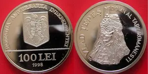

Tombac is a brass alloy which contains approximately 85% copper with 15% zinc. Its color is more "golden" than the yellow color of typical brass, which is 60-75% copper with the remainder being zinc. Canada made Tombac 5-cent coins during World War 2. See the color in the photos of a couple of uncirculated ones, attached below.
Many people do not know that there is another variety of Tombac, called "White Tombac." Like normal Tombac it contains about 85% copper with the rest being zinc, EXCEPT for the addition of 1% metallic Arsenic. Strangely, the Arsenic 1% is enough to change the alloy's color drastically, to a "silverish" tone.
Also kinda strangely, most White Tombac buttons come out of the ground very nearly still shiny, with almost no patina-buildup at all, because the 1% presence of Arsenic in them seems to kill the microorganisms which help form the patina we typically see on excavated copper-&-zinc alloy relics.
When not excavated, and highly polished, White Tombac looks like what you see in the photo of a Romanian "Vlad Teppes" 1998 commemorative coin, attached below.
The professional archeologists who call the Colonial Era silver-ish "spun back" 1-piece buttons "Tombac buttons" are metallurgically ignorant. In actuality, those buttons are made of White Tombac.

One more time, because some people have forgotten seeing me say it previously many times.
Many people do not know that there is another variety of Tombac, called "White Tombac. Like normal Tombac is contains about 85% copper with the rest being zinc, EXCEPT for the addition of 1% metallic Arsenic. Strangely, the Arsenic 1% is enough to change the alloy's color drastically, to a "silverish" tone.
