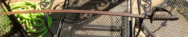

OK folks,I now have the sword in hand.Overall length is 401/2",blade is 35".The story is that it was found in the rafters of an old house built after the civil war.There was some action in this area and it was occupied by both armies at various stages.Here are some better pictures.

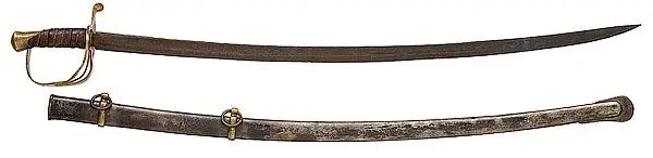

BANNER FIND -YOU HAVE A VERY VALUABLE SWORD!!!! It is a "DOG RIVER CAVALRY SABER" -CONFEDERATE!!!!!!
AND THE SCABBARD IS WORTH ALMOST AS MUCH AS THE SWORD!!!
I had one just like it in the 90's sold it during my divorce (which I regret to this day).
BE sure you do not clean it any more. Leave it alone. I've nominated it for a "Banner Find"
If it was made in Mobil Ala it would be worth quiet a bit. It almost looks to be an ames light calvary sword. A dog river is 40.5 inches. There should be some I.D near the pommel were struck maybe not. It is in very poor condition unfortunately . You used to be able to pick up the old wrist breakers for around $400.00. Condition is everything for a good price. Please do not do any restoration yourself if it turns out to be a rarer and possible confederate sword :thumbsup:. Very cool. I like swords.
The fact that it has no markings than the two marks(roman numerals?) on the scabbard throat and guard,unstopped fuller and a rather crude casting of the guard leads me to believe it would be of confederate manufacture.The wire on the handle is iron(checked it with a magnet).Until I figure out for certain what it is I have no plans to clean it and then I'll probably leave that process to a pro.Thanks Dave.

It looks to me to be a Kenansville Second Model Cavalry Saber. The scabbard is marked with a roman numeral II and so is the sword. Here is an example for sale..... Artifacts For Sale
That is a rare and very cool example you have.
Steve
I have to agree that this is a Kenansville Armoury product.The only variance is the iron wire wrap on the hilt,where the ones I have seen appear to be copper.Other than that,everything else checks out.Thanks,David.
I agree, it appears to be a Kenansville. Froelich put Roman Numerals on his swords. I have XIX on mine. If you could take one more photo of the sword looking down blade so that you could see the "basket" or hand guard, it would help. The non-stop fuller definitely points toward a Confederate sword.
