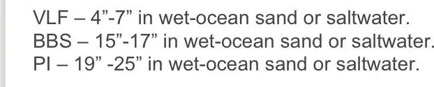

You might find less junk, but the sand shark will go a foot deeper than your excel !!!
I've owned the 8 and 10.5 sand shark, dual field, B.H. ID 300, and have an excal.
A food deeper then my excal? I beg to differ!
I admit I found a lot with my shark in VCO but a foot deeper... Don't think so!
I'll take 15"-17" with no junk for a hundred Alex!
If I wanted depth with trash I'd just swing my dual field pi, it smokes a sand shark on depth!
What target is that depth on?
