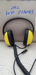

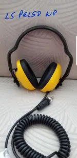

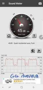

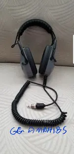

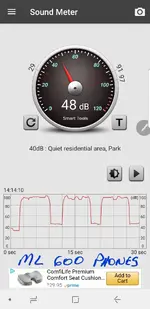

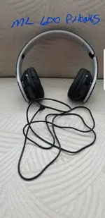

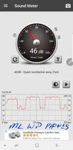

Here are some screenshots from a sound meter app I used on my phone. My phone has mics on both ends of the phone so I just placed it between the earcup on each phone set. I waved a gold wedding band, penny, and dime across the coil (with pauses in between) and recorded the resulting audio graph. The phones tested were:
The ML wired phones that came with the 600
The LS.Pelso WP Phones from Kellyco
The ML WP Phones
Custom modified GG Amphibians
Results: LS.Pelso's had best volume, sound quality, sound isolation, and comfort.
In terms of volume the rankings were: LS.Pelso, ML 600 Phones, ML WP Phones, and the GG Amphibians bringing up the rear at about 15-20 db below the Pelsos on average.Screenshot_20180825-144706.webpScreenshot_20180825-144607.webpScreenshot_20180825-144518.webpScreenshot_20180825-144423.webpScreenshot_20180825-142443.webpScreenshot_20180825-142412.webpScreenshot_20180825-142331.webpScreenshot_20180825-142253.webp

Results with phone app for Minelab WP HP for the Equinox using Silver Dime at 1”
Fairly close to the analog readings.
