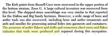

My guess is that the reason you find them on the Ft. Ancient sites is due to late age. But, they actually were continually used on record going back to the advent of the archaic era in many places.
One of the earliest clear records I have found, so far, is from Russell Cave. I know you know your points, so you will probably recognize the ages, here.
Check out that drift flaker!
As I am sure that you know, this is advent of the archaic era level material. And, there are perfect antler drifts!
