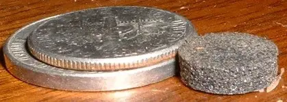

The Probes have a Small Piece of Foam in the Lids
Mine Came out
If you are having Problems with your Probe Shutting off,
Check to see if the piece is Missing, Or crushed.
A fix may be as simple as putting a Nickle under the Cap
the actual Thickness of the foam Matches a Nickle & Dime together

But Foam Compresses
Good tip Jeff. If the battery can't get a good contact it won't work.

Thinking about it, Half dollar may be good
enough too
Half dollar won't fit
unless you press it in perminant

If my probe looses its foam I think I might try a dab of clear silicone, about the diameter and thickness of a nickle. That should be a good fix. If it ever happens I will test it out, and post it, if not well................................................. ???
