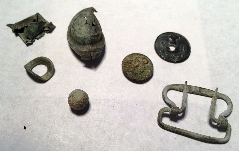

Tom and I had some sites researched we've been waiting to check out, but when I knew my Impact was finally on the way, we sprung into action to research a few more to add to an Impact test trip, mostly remote stage stops.
Unfortunately someone already cleaned these sites out, and I mean clean. Some of them hardly even had iron, others still were laden with iron, but stingy on period conductors. We hunted a total of seven sites, including one we've been already working on (at least it's still producing). Not a single period coin was to be found, that was disappointing, you'd think one or two would've surfaced, but their tired sites.

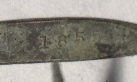

This photo shows some of the relics from the stage stops. One is a little suspender(?) buckle dated 1855.

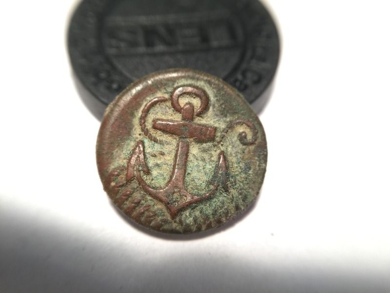

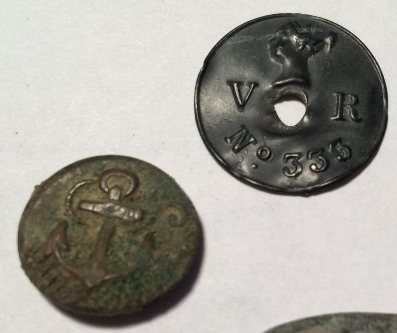

This Naval button and this other disc came from a stage stop. The Naval button across the top of the anchor appears to have I O U written, but it's challenging to see without a loupe:
Anyone got an ID on the button?

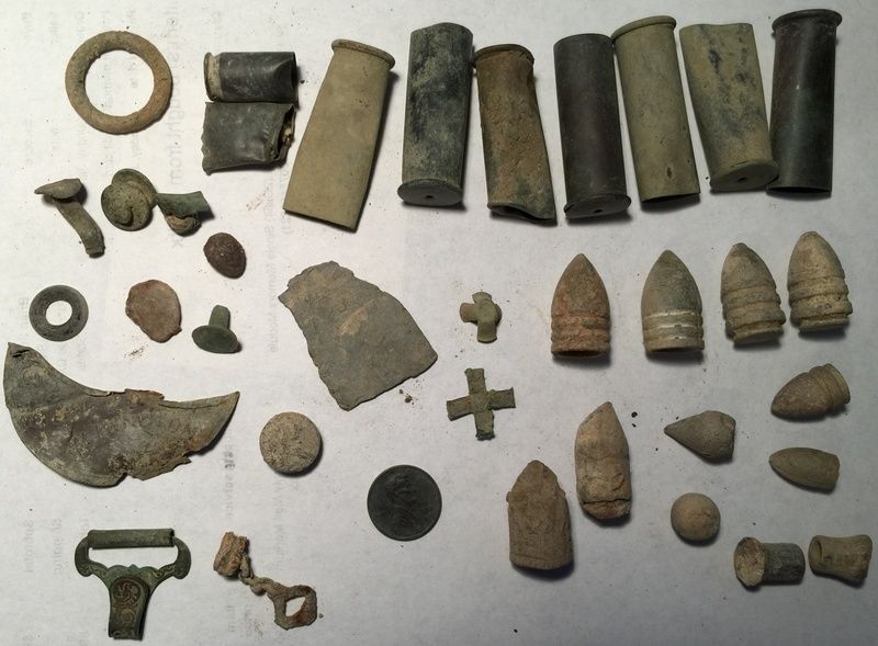

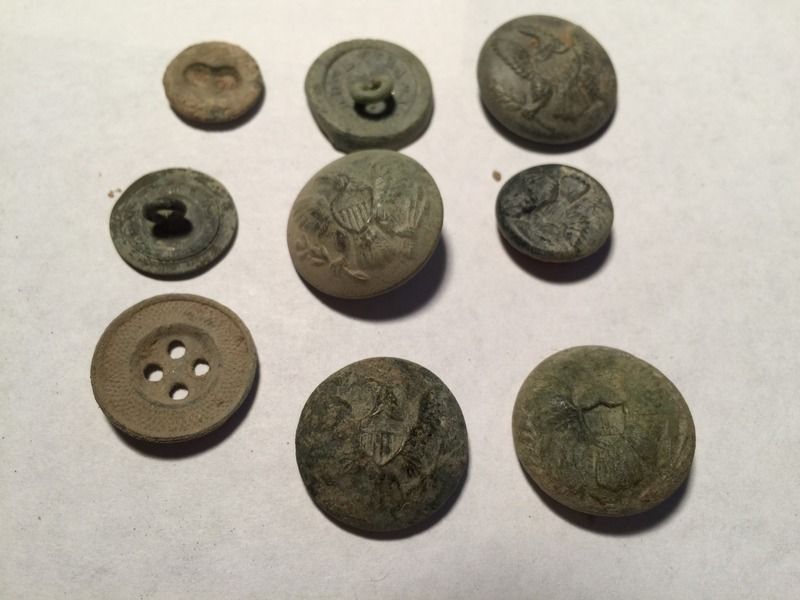

Last is our Western Frontier camp, it's still producing:

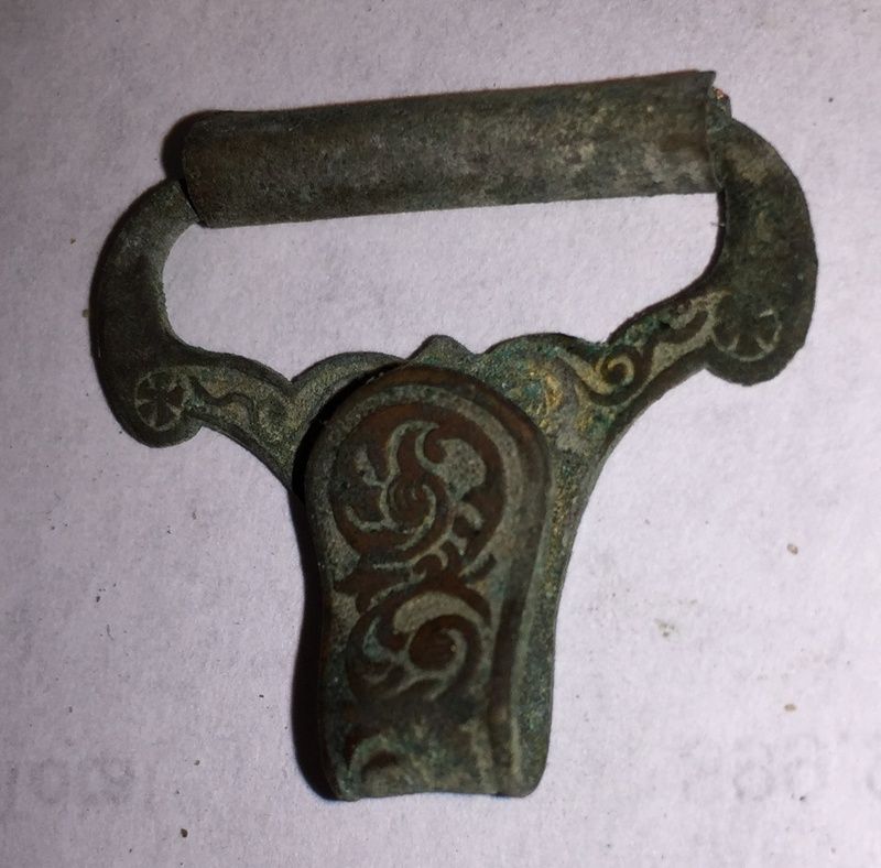

Things of note were the lid to a gunpowder can, and a screw on lid to a black powder can. Also found a nice ornate suspender clip, eagle buttons including an Infantry I in shield button, still no shortage of lead and Spencer shells. I'm sure there's got to be a few more good finds to be made at this site, but it's definitely thinning out.
