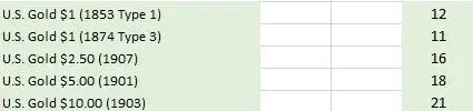

Can’t sleep wife to had a back surgery and I taken care of her to the best of my ability. She’s sleeping thank goodness and now I can’t sleep truly sleep one hour since weds at 8 am. But anyway you now how it is when you can’t sleep you experiment with VDI. Ok this hit at a solid 16 which I pass up 90% of the time the ol pulltab. Well maybe at a park or beach but I cut a man’s one acre lawn to to detect it tomorrow. 1810 property. Remember solid 16 I’m digging them all tomorrow. IMG_0012.webp

Truth, wanted to show you how an E-TRAC reads a $1 Gold coin. 11(ferrous) and 11(conductive).
Reads exactly the way a beavertail from an old pulltab reads. Bet I dug thirty beavertails and over one-hundred pulltabs this week. I look at it this way, the fact that I am at a location that is littered with pulltabs tells me that I'm in a good location because everyone else has discriminated these out.
Here's a target from two days ago that read 12-25, just like an old pulltab with a beavertail...
Depends on which gold coin, as well as other targets like iron, foil, ground mineralization interfering with the gold coin....no absolutes in detecting...but in an air test :)
I would dig all numbers from 12 to 18. As stated before, ground conditions play a role in what signal is produced. Good luck on your hunt and bring one home!:occasion14:
The almost pure gold coin you may find on a 1810 property wouldn't be the same diameter, nor the same content, as a new 1/10 ounce pure gold coin.
Look guys, the way to find a gold coin is it being sandwiched up with a large silver! lol (wouldn't that be nice!)
Good luck on the outing and HH ALL
Gold, depending on shape, depth, alloy, size, and many other factors, can read all over the scale. Your 1/10 ozt gold coin reads 16 on the vdi. A gold ring will read differently, as pointed out by SD51. Many gold alloy chains will read as a “chatter”, similar to a bunch of iron bits on top of one another. A 6k chain, if very high in copper and silver, may read as high as 80 or 90, but still a broken signal.
In short, if you want to find gold, be it coins, rings, or chains, you will have to endure the monotonous task of digging everything.

Here you go, Truth...this may help. (Tests in Park 1 mode, with my EQ 800)

Lol man I’m gonna go for it SD51. And that you so so much for wishing my Queen well [emoji1317]
