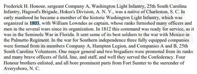

Here is another 1803 reference from a Confederate Veteran's Newsletter in 1909:
attachment.php
I also see 1807 in a number of places around the internet. Maybe the organization recalculated it's origin date? :dontknow:
It seems 1803 refers to the Boston organization.
