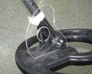

The big coil does have a problem in strong current of tilting up as the current rushes against it but some extra washers and two pair of pliers solved that. I think whites needs a double nochted system and a better bolt then what they have on it now.

Good write up and your observations on right on par with what I found with the PI Dual Field. You may want to try a coil stabilizer to eliminate the coil tilting problem. I usually make my own as they are easy to make and you can mount the coil at the perfect angle for you. Good luck with your machine, sounds like you have it figured out already.
How about a pic of the brace? I guess you use plastic? Wouldnt metal interfere with the signal?
Here's the pics. You can use about anything plastic about .125 (1/8") thick. Need a nylon screw and wingnut and a nylon cable clamp. Make sure the bottom of the stabilizer is tight againt the coil. I usually drill the hole for the coil attachment bolt and then trim (sand) the bottom edge of the stabilizer until it will just slide on. Put the cable clamp on the lower rod, adjust the coil angle and then mark and drill the hole for the nylon screw. You can drill a whole row of holes for the nylon screw to make it adjustable.
