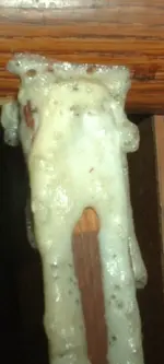

did you wet the item before using the glue ?
GG Activates with Water.
Only Bad thing I have had with it,
if you use allot it bubbles up before it dries
View attachment 1604280View attachment 1604281
in Spite of the Ugly Look,
Still My First Choice when I need something to Last.
and looks don't matter.
I don't ever remember using it on plastic .. so :dontknow:
My Second Choice would be PC-7
yes siree bob i did. and i even went as far as scuffing it up a bit. you just cant imagine the disappointment. can ya ? and just a note Jeff it says right on the bottle not to use alot. but as i've learned life is a matter of perception. so in your picture maybe that was'nt a lot for you anyway ?
