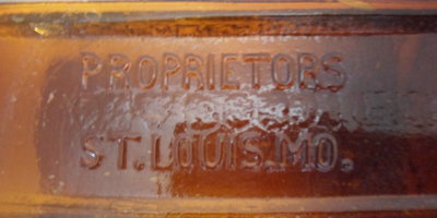

I got this one from an antique shop here in Northwest Missouri. I am thinking this is from a reworked mold, looks like it used to be a shoulder seal.

Any idea where i could find any information on it? I have researched some of the Ball sites and could not find anything on it. The chart for logo history does not even have this one.
Anyone have any idea? Any and all feedback or comments is appreciated.

I notice, or think I do, that the "B' in Ball seems to have an extra long back flourish. Is this what you are indicating? I see no dropped "a," which makes me think post 1923.
I'd ask for some additional comments from you, and some natural light photos, please.
Yes i am referring to the Logo. The B is actually one continuous line without breaks in it.
Looks like the glass has some texture too. Be careful of reproductions...
How do i tell if it is a repro?
I found the answer everyone which proves research prevails.... While in an antique shop today looking through fruit jars i came across an old Port Mason's jar and it came to me that this jar came from a reworked mold. Ball had bought Port in 1904 they continued for a short time to make jars there. I suppose they continued to make them at first with the Port logo then changed to the well known Bally logo when they engraved Ball over the Port inscription. Here is a link that has this information BALL over PORT Transition Jars in Transition Jars Forum

Please post some more photos of the jar, and the lid, in natural light. It appears to have some whittle.
Do you see evidence of peening out the "ort?"
Could you explain whittle? And the other "ort" to me?

"Whittle" is the term that bottle guys use for the wavy, rippled or whittled effect that some bottles and jars have on their surface.
"Whittle marks - (Also called "chip marks," "chip mold," "cold mold marks," "whittling") These terms refer to a bottle glass texture which has a wavy, dimpled, or hammered appearance. Called whittle marks, because the bottle surface looks as though it were blown in wooden mold where the mold maker's whittling marks are evident. (Wooden molds were rarely used during the period covered by this website.) The glass texture effect is usually actually caused by the hot, semi-molten glass hitting the cooler mold surface; bottle "goose bumps" in a sense. The image to the left shows a close-up view an extreme example of this effect; click whittle marks to see entire image of this large 1850s patent medicine bottle with the extreme whittle marks." Bottle Glossary Page
What I meant about the "ort" being peaned out, was that the mold cutter would have had to modify or remove the "ort" in the Port mold, in order to recut it to the Ball logo.
"HOME BITTERS CO two slug plates was peened out and new lettering added." Bottle Pickers​
