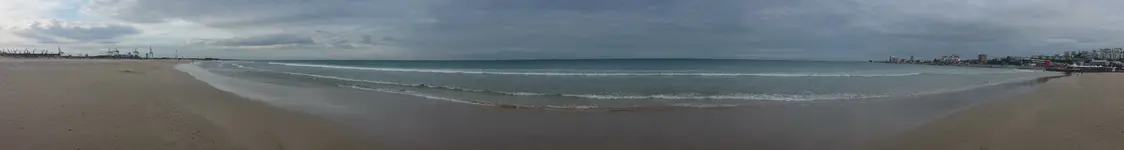

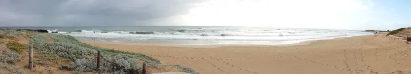

Thanks for all the advice guys - I will have to put in some hours this week to play around with some settings. We are heavily sanded in and i think it plays with the mind quite a bit. Im always scared of backing down to much on sens that it will limit my depth and missing something but i also do understand if i dont then the falsing will drive me crazy.
Photos of our beaches in pano :)
