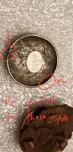

I asked about the tabs specifically and he pointed out the places I have circled commenting that "those oftentimes broke off." He stated that there were different types of attachment and although his button may not be an exact match, he was confident due to the location where it was found and the style of the rosette/accoutrement that it was time period for the battle.Screenshot_20180628-152106_Gallery.webp
I asked about the tabs specifically and he pointed out the places I have circled commenting that "those oftentimes broke off." He stated that there were different types of attachment and although his button may not be an exact match, he was confident due to the location where it was found and the style of the rosette/accoutrement that it was time period for the battle.View attachment 1606217
Thank you for the extra info & time , I can see where he was talking about the attachments being.

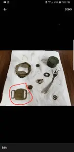

I found this about 20 feet from where I found the US brass accoutrement. I am seeing these listed as Civil War era as well. Is this more misinformation as well?Screenshot_20180628-190155.webp20180623_115227.webp
It is a WWi era harness brass ..not Civil War. The other is a post war harness buckle cover.. not Civil War either.
It is a good find regardless of its age. Don't take it as anyone is trying to discredit your find. Horse tack, rosettes, martingales, etc can be tricky to pin down a time frame to. My experience with items such as yours is that the attachment method has a distinct progression through the years. Civil War era being lead filled with an iron attachment bar, WWI era having a metal backing with iron attachment bar, and later pieces having the prongs made into the stamping, which perforated the leather and were then bent over to attach the device. I think a lot of the confusion in the ID of these pieces comes from the fact that a lot of CW battlefields were also used for military training in preparation for WWI, WWII. I don't think that is the case here, as it sounds like it was a small skirmish area, but I have had later military items show up in the strangest CW areas in the past. Like the others have said, any military find is a great find in my book!
