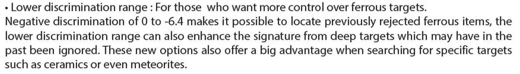

Ok, I have been using a deus since Christmas. Kinda getting used to all the bells and whistles after starting with an at pro. Now, ver. 4 comes out with negative disc. Explain this to me like I'm a 5,year old. What does this bring to the table?

Negative is basically for hot rocks and or bricks or tiles that are buried in the ground....these things can make the detector unstable
Or look at it as 2 separate scales instead of 1.........0-99 is the metal scale and -.1 to -6.4 is the mineral scale
So, if bricks and hot rocks are not an issue in my area, then it doesn't do any good or any harm to go less than 0?
I don't think it hurts....from what I've read going negative helps with iron wrap around as well....i haven't messed with it much

I'm thinking - disc will shine in heavy iron or at old foundations.....

Here is the verbiage direct from the Deus website on negative discrimination. Just as Tedyoh alluded to, these low numbers help a person to identify ferrous items and aid in picking up deep targets as well. I noticed the negative discrimination is set on the new "Hot" program. As for me, this was way too much chatter which I am not used to. So I just changed my discrimination to 10 and it made the Deus much easier on the ears. Other than that I am loving this program. Works really well.
