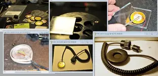

ok -gotta ask - whats a bone phone??
Here are some pictures. The red part produces the audio. They are designed to be wedged between your wetsuit hood and your skull...thus the name "bone" phone. You can also just wedge the wire under your mask strap and kind of leave it dangling near your ear. I do this a lot when I am working really shallow areas with a snorkel in the summer. In any event, it is impossible for air to be trapped inside one, unlike with conventional headphones. If you actually wedge one right beside your ear while wearing a hood, you can hear the faintest signals and keep your threshold tuned very low. They are less bulky than headphones, lighter than headphones, less likely to tangle than headphones, and their construction makes them more durable than headphones. Plus, if you have one under your hood, and you stick your head out of the water, you will not even appear to be metal detecting. If you need to be a somewhat "cloak and dagger" you can run the wire under your wet suit or shirt. If you hip mount and use a short rod...or even NO rod, you look especially nondescript. Even though metal detecting underwater is perfectly legal in my area, I like to be as discrete as possible...I use an old Aquapulse 1a primarily and believe it or not, many people just assume the control housing it is some kind of pony bottle or egressor...it kind of has that look form a distance...
bonephone.webpclick to enlarge
Also, I am not sure about the new style Garrett underwater headphones, but on the old style phones there are two screws, one on the side of each earcup, that are supposed to removed before diving...I believe this is to aid in preventing air from becoming trapped inside the earphones and limiting the audio.
View attachment 867704click to enlarge

Have made a few bone phones over the past few years.
I agree if your using the Garrett blues they should be plenty loud, maybe a leak in the cord has causing corrosion which can allow less power to the Piezo benders. I don't dive but from the divers I have made headphones for they have said timing helps a lot. If you need a set of the Gray Ghost Amphibians I can set you up, I go thur each set and check for quality control and fix if needed, this allows for deeper diving and longevity of the GGA's.
