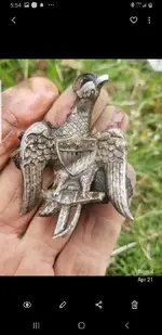

Can anyone identify this?

Cool find, maybe someone can give you a more definite answer, versus speculation on my part.
I cannot for the life of me find an example of this badge. It looks like the eagle is on an anchor, which would make it Naval related, maybe a Navy Cadet.
But I cannot narrow it down to exactly who and when though, other than a possible Naval connection.
That's a neat find. Interesting to look at the eagle's feet. Looks more like a canary than an eagle! Gary
The shield has five stars and looks like some of the insignia from 1812 period but the eagle does look odd. I also thought it was clutching a sword or scabbard. I’ve searched everywhere and cannot fine a match. This was found on a 1700 property in mid coast Maine. 10 feet from it was a civil war uniform button.

Here is the back. I’m at work so no cleaned up picturesAAE52FA7-293C-4760-A0BF-2B5C412D4AAE.webp
The eagle still has bits of felt attached to the rear, possibly from a service hat

I'm thinking pre CW hat badge. In general, hat badges were not uncommon at all. I haven't seen this type before. I also see an eagle over an anchor.
seems odd that there are 2 rings on the back side under the wings and one at the top

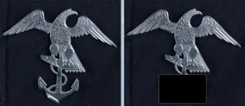

Here is a mid-19th Century Navy Petty Office badge:
Did more reading. Now I'm thinking - not a hat badge.
Here is a thread on USmilitariaforum that discusses metal rank badges worn on the sleeve of Navy Petty Officers around the time of the Civil War:
https://www.usmilitariaforum.com/fo...prentice-badges/&tab=comments#comment-2405594
Included in the thread is this badge:
There seems to be some debate as to when these were worn but not much question about who wore them. I'll admit, the more I read the confusinger and confusinger it got. :icon_scratch:

I may be looking at this wrong but I don't see an anchor. I see a sword hilt.
What looks like a Sword Cross Guard is the Anchor Stock, what looks like a Sword Blade is the Anchor Shank, above the Anchor Stock is the Anchor Ring, what looks like part of the Sword Guard or Knucklebow is the Anchor Line. I originally thought the same thing when looking at it last night, then I realized it was an (sword), I meant anchor.....
ETA: Fixed my typo, I put sword as the last word instead of anchor. Leading to confusion that I was stating it was sword, when all the information above showed I meant anchor.
Not a sword.
It's a mid 19th C Petty Officer's rank badge. Eagle on a fouled anchor. But the bottom portion of the anchor is missing.
Thanks for the info on that site. I found something similar and if you look at the top of the anchor and it’s chain it’s very similar to the one I have.
