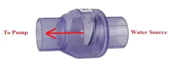

Put a check valve on the end of the suction tube that goes into your water source. Fill the pump chamber and allow the water to flow from the pump chamber into the suction tube. Continue filling until the chamber is full and the water is standing within the chamber. A check valve will only allow the water to flow in one direction, that direction is towards the pump. When the pump is off the water will flow back into the suction hose and will close the check valve keeping the pump primed. The key to getting a pump to work is you need to have enough water to start its cycle of pumping, this is why the check valve needs to be at the water source.
I work with large check valves of 12" and these valves are installed at the waters edge of ponds that pump water for entire golf courses.

Can't get any simpler and cheaper thin this very simple design of a check valve. About $10.00... Plus you can see into it in the event something is keeping the gate from closing. These are available in America not the inflated price in the UK...
