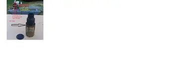

This is a footvalve. It should have a rubber flap in it if you want life to be easy, but not all of them have it.
If you in large the pic I out lined where this goes on the pump
also check the flapper on the footvalve to see if it is bent out of shape by NOT storeing it correctly! I saw a guy in Colorado trying to prime his pump by pumping the foot valve up and down for a LONG TIME only to finealy get to me. I asked him if I could look at it. he said he thinks the pump is shot! he said go ahead! I looked it over and decided t oopen up the footvalve. sure enough , the flapper was warped open from not storeing it properly.I removed the flapper and flipped it over and put it back together and it primed up and run fine! this guy was sooooooo mad about his pump (being shot) he would have sold it to me cheap! and now he was running just fine with some good info! very good points were brought up here as to leaky suction lines (to the pump/footvalve) and keeping the jet under water! sounds like you just need to get with someone that has more experience with this. this man drove across 2 states to do this.............I kinda saved his week!
ok i got it now.....i actually took it off when i was getting everything ready because they had it ducktaped between the filter and hose, so it either broke off, which the ends dont look broke, or this is just a seperate piece and he didnt have the right connectors so he duct taped it.......But i do see now, and plan on connecting a hose to the filter then to the foot valve, like 6" or something, then a hose from the foot valve to the IN hose, again like 6". The hose i have fit both so that would be perfect unless you think that will be an issue?
That duct tape is most likely just to keep the band from cutting up their hands.
No it was actually hold the pieces together....no band, just duct tape....lol
The end of the filter is the same size as the end of the foot valve piece....so they duct taped it together.
i put the clamp on the one in the picture i was just trying to show that it was a seperate piece and had a flapper in it.
