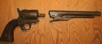

I was cleaning my cellar and came across this revolver in a bag. It was in 4 pieces, the handle, barrel, cylinder and threaded rod for the cylinder. Everything went together except I can't get the rod into the hole under the barrel. The bore dia. is apx. 15/64". There is a patent date of 1850.

The only numbers on it are 7326. I can find no other markings or manufacture name. Diameter is wrong, should be 15/32.
What ever you do, do not use a steel brush or any abrasive cleaner.
You can put a small amount of oil on it.
Take it to an expert.

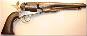

Yep it sure looks like a colt. I agree with tabdog about doing anything to it. Very cool

You need to remove the wedge in the slot. Could that be the problem? Its been a few years since I dissasembled one. It holds it all together. Or maybe a piece of metal is in the slot.

yes wedge out wedge back in after assembled

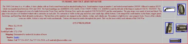

Yes, 1860 Colt army. Serial number 7326 would make it 1862 production. Be careful how you treat it it is a nice early revolver!

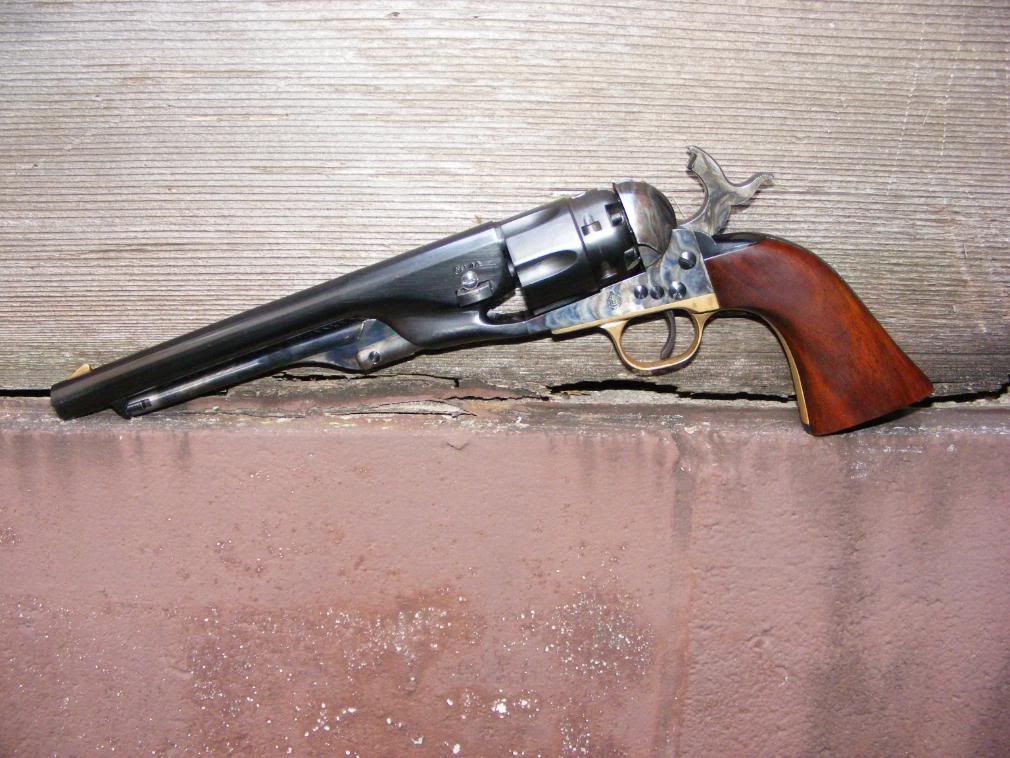

I love the 1860 colt. The one below is a Uberti replica made in 1970. I love to shoot it, it is a blast. Very impressive at night or low light, as my avatar shows.
