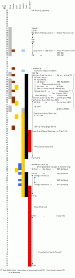

What coin?  Here's a whole bunch. As they go deeper thay may also shift one ot two units down the scale. And this scale is for a specific detector (the F-75). It's not a standardized measurement. Yu'll notice that for EVERY old coin there is some type of trash in the same range. T.A.N.S.T.A.A.F.L.

Re: what VDI does your old coin (pre 1900's) show up as?
bomber said:
depends on what your swinging
Sorry, I'm swinging a DFX. (didn't know VDIs differed all the much between machines).
differant machines have differant sized number ranges -- the more numbers there are then finer they "split hairs " --- thus the better they can rell the differance between pull tab and gold ring -- in theory at least -- a pulltab that reads 34 or 35 and a ring that reads 35 to say 36 in a 0 to 99 range machine -- might read 33 to 34 pulltab and 35 to 36 ring in a 0 to 199 model --due to the larger "spread" of numbers avialbile to classify its finds into-- of course many factors effect the VDI reading -- soil conditions --coin depth and angle --and its metal make up for starters . but there are "known" good coin number charts out there for each of the machines --- keep a record of your finds and record the numbers as you hit "pay dirt" -- thus making your own chart that takes your local conditions into account.

I like it. It is "twitchy" but can be set lower if it gets annoying. There are several ways to "dummy it down" for quiet running but they invariably cost you depth. Very light, very fast. It's the first machine I've had with a display so I took the time to log everything I dug and ran it over every type coin I could find (many of those were laid on the ground in mylar flips, I admit). I'm a coin shooter - even when I'm in the woods I'm hoping for coins - but it seems to work great in all metal too. The VDI is very consistant and that's a Godsend in trashy parks. I've got so I don't use much discrimination at all but let the meter tell me what's garbage and what's not - but I still dig a lot to be on the safe side.
