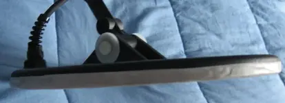

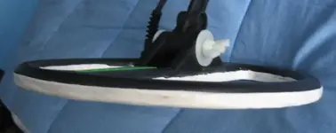

I use Loctite Marine Epoxy on all my coils. I use to just epoxy the bottom of the coils and touch them up a couple times a year but now I epoxy the covers directly onto the coil.
For the record, Minelab does NOT void the warranty if you use Loctite Marine Epoxy but does void the warranty using other materials such as bed liner spray.
Here's one method just using epoxy.
Another Method That Works Excellent
Another method that worked quite well was cutting the coil cover as shown and epoxy just to the edge of the coil and epoxy the entire bottom. The edge should go all the way around, not the way shown. This was the first one I did like this and only did the area that got worn the most.
