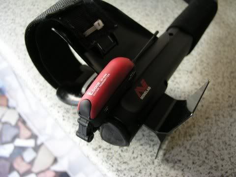

Any of you USA E-Trac users gone wireless headphones? If so, what and where did you find your setup?
I'm asking because I see on another forum some users from overseas countries are using a T.Bone GT EWS electric guitar transmitter with Technika TA 709 wireless receiver headphones.

Here's some info posted by Tony Hunt that might be useful.
http://www.mlotv.com/view/477/t-bone-wireless-transmitter-technika-headphones/
http://www.mlotv.com/view/478/sound-test-on-coins-with-the-wireless-phone-setup/

Reply from the German T.Bone rep...
"Hi there,
you can order this from us but you would have to check locally which frequency you can legally use this in your country. The frequency these items work with are 863.000-865.000MHz and 863.125MHz - 864.875MHz. These regulations vary from country to country. The price would be in Euros as we are based in Germany. The US price can change daily due to the exchange rate. The shipping costs would be 30 € for that potential order."
