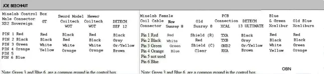

Sorry for all the questions.
How does the wiring match up for a hard wire ?
Same color codes, amour of wires ect?
Thanks I'm so taking notes and Jamaican me oppy!
I use mine only during the winter, and that's about it. Really has to do with where you hunt and your needs. I took mine off and setting up the machine with a little smaller, 13 Ultimate. But I am hoping by spring I will have a endcap that we can change out the coils...so one machine does not get tied down to a few hunt sites or conditions.
I have two Excals myself. One with the WOT/stock changeable connection and one stock hardwired. Both have their place in hunting the beach. The WOT is great for coverage and deep targets. The stock coil is better for trashy areas and in the surf. The WOT is tougher to swing under water. Coiltek makes a kit that comes with a external water proof connector so you can swap coils if you wish. I understand it's not fool proof but if you wrap the connection with rescue tape, it seems to work fine......so far.
