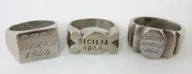

Argenitium, here are some other examples from ww2. Sure look like home made image-2139998674.webp image-4040314304.webp image-2092001977.webp image-2345965258.webp image-2262827812.webp
Especially #1, made from a coin ;)
