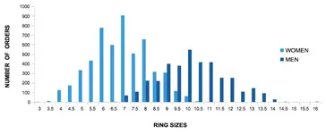

I will dig a hole to reach the "hard pack" level under the pebbles (since I think that all goodies will make their way through the pebbles and reach this level) and will test 8khz vs 28khz with a really small woman gold band.
*I bought a 14k small 2mm thick gold band No4 for the testing. According to the attached plot, which is based on 5.000 orders in a well known jewellery site, No4 is almost the smallest women ring size so I believe that my sample is good enough to judge.
Thinking here is that, as long as tiny gold chains and tiny earings are a completelly different and difficult animal that I'm not after, and I'm only after gold rings, I'm searching for the deepest but steady setting to hunt there...but still be able to clearly hear the rings, and hopefully handle the salsted seaweed falsing problem and avoid the tiniest aluminium pieces with vdis <45.
