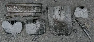

And the ferrous. I dig lots of hoe blades, but to get 3 complete ones in one hunt is uncommon... and I actually dug 4 broken ones as well. I have about a dozen hand wrought complete hoe blades in various display cases, but the tiny triangular shaped one was a new one for me. My favorite two pieces of iron are split between the Curry Comb and the complete Spade blade (shovel). I have dug many broken spade blades and even one I broke while extracting, but this was my first complete one. The Curry Comb is also my first and came from a very old spot.

This Spade blade had me smiling! Its only missing one of the foot pads on one side, but otherwise in well used and worn condition. Incredible to think what sort of holes the were able to dig with these old boxy shovel blades.

The flower pattern on this piece of cast iron was too cool not to process. Included is a before and obviously after photo.
Hoe blades with a interesting tiny triangular one.

Some before shots of the tools and utensils.
I took some pictures of the tools after electrolysis and before hot wax. The wax always dulls the finish and darkens them, but before cooking they have a nice black metallic finish.
I had to fire up a second pot to cook all this stuff today. I typically use just the small one, but with some larger pieces I had to run dueling pots of boiling wax... what could go wrong?! :laughing7:

Super post as usual. Tough to call my favorites of the bunch, but the floral cast piece (would that have adorned a mantelpiece?), spade blade, and those cufflinks I spy really pop out...the latter in part because I've never dug one, let alone a set.

Thanks a ton man! I've been looking at that piece of cast iron and trying to figure out what it was. I was thinking mantle or large wood stove too... or something like that. Its broken in half, but there are two bolt holes on one side. One hole has a bolt in it with a square nut on it... so It's got some age to it for sure. Not sure if you remember, but last year I got on a freaken cufflink streak on my sifting trips... I ended up with something like 17 links from my main site, with a linked set (my first). Funny how that happens. This was my second complete linked set and I was really hopeful they weren't toasted, but they are. Hope you get one soon. I run my Deus in a higher frequency (18khz) that hits better on smaller targets, so perhaps that's why I keep finding them. :occasion14:
