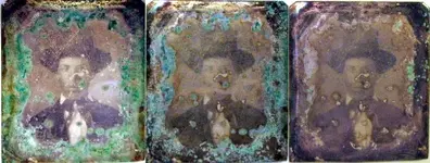

Today was "D" Day (Do it Day) ;D I submerged the photo into Ammonia and Water mixture, I was greatly concerned about whether the copper chloride would adhere to the portrait as it was dissolved by the mixture, At first there was a problem, I was a bit cautious intially only submerged about 1/4" of it in the solution. Well, after a few hours of doing it and rotating the sides into the solution, I noticed the solution "wicked up" into the portrait area, and left a blue scum line!! :o
So, I made the decision to go all the way and completely submerged the photo into the ammonia and water (2.5 to 1 mixture).
That was the answer, I am not done with this portion of the conservation but almost. I am showing photos of how it looked when I started , then at one hour, then at two hours.
I am now at almost four hours of soaking and 99% of all the blue is gone. Once that is off, I will soak in distilled water till I am ready to do the electrolysis portion, hoping it clears up some of the foggy appearance.
I plan on trying the electrolysis sometime late tomorrow or Thursday morning, must go out pingin in the AM :> The darkness on the photos is from using a different light source for the last two pics. :)
Don

IF this comes out pretty decent, considering how bad it is/was, I will group together in one reply a complete procedure...
I could almost get some enjoyment out of sending the before and final after to the Conservator who quoted 500-1000, with no guarantee of being decent. Also, he questioned whether it was a Daguerreotype, thought perhaps it was a unusual paper one. ;) Nope :)

Thanks Will, well at least the soak portion is over, the portrait is now in distilled water till my next step, which is the electrolysis. After I detect tomorrow, I will then come up with some type of setup to hang the portrait vertically and hang the anode (mercury dime) in front of the portrait, centered as much as possible, then garner enough courage to do this step!
Now, I hope the electrolysis works. :)
Attached photo is when it came out of case and as it is right now.
Don
