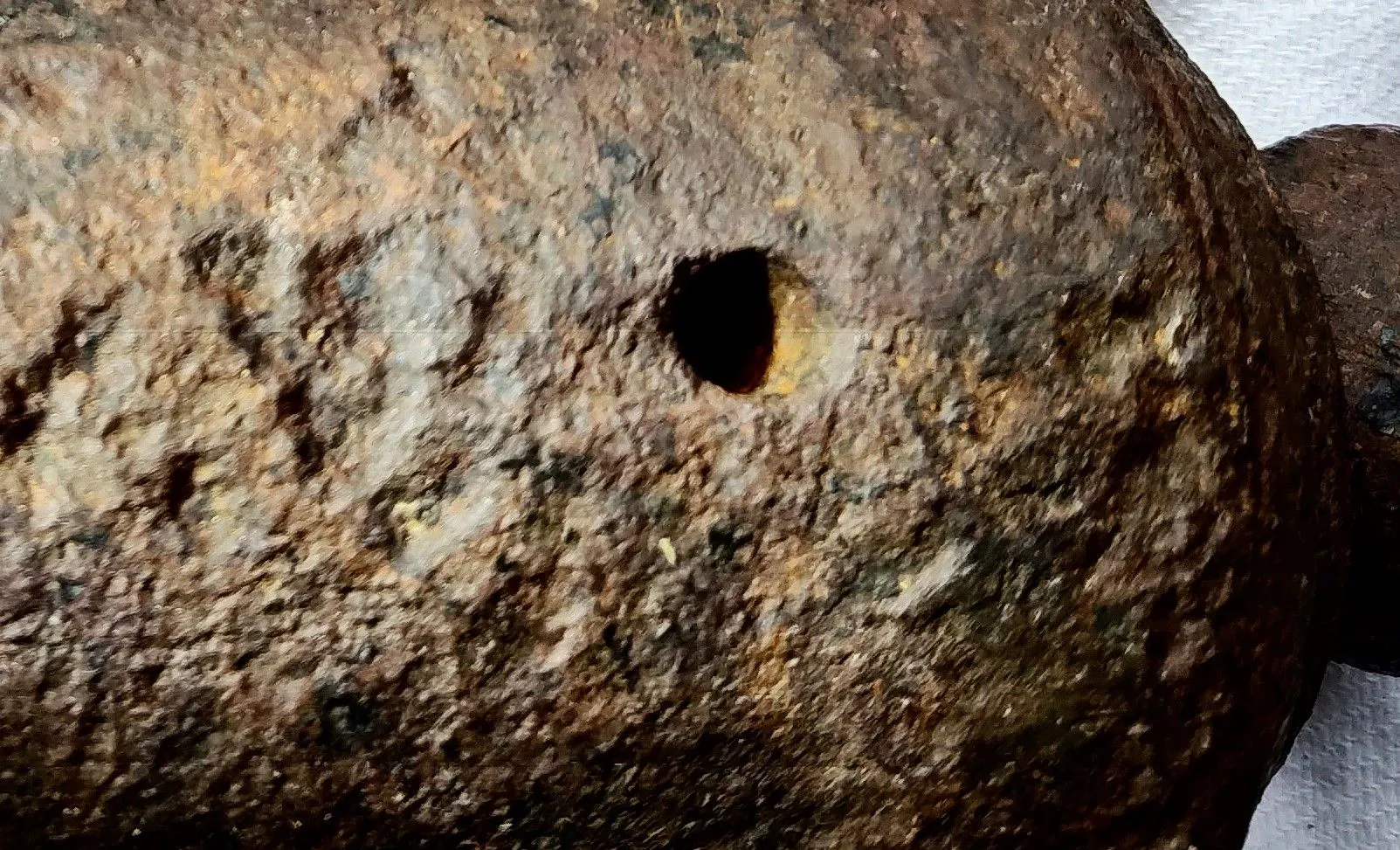

Hello,
New member here, I recently purchased this antique cannon. It was sold to me as 18th century, possibly Dutch. I was told it had been under water. I believe it to be a swivel gun. I was wondering if anyone can identify it's nationality or verify that's it's 18th century.
It's fairly pitted as you can see from the pics.
Dimensions are:
Length 27.5 inches including cascabel
Barrel 26 inches
Width at breech 3.5 inches
Width at muzzle 3 inches
Bore width 1.5 inches
Trunion diameter 1 3/8 inches
Weight 47 pounds
I don't plan on attempting to fire it but would like to make a display if I can find a yoke.
Thanks for any comments

Hard one- my guess is Swedish, with a small possiblity of being cast in Asia for the Dutch East India Company. But real, not ornamental
I should add that the Dutch bought their cast-iron guns from Sweden as they did not have the resources to cast iron in the Netherlands, so it could still have been intended for Dutch service. That shape of cascables suggests an 18th century date.

So busy you feel obliged to make 4 separate replies? Hate to see when you have time on your hands. It is not a garden ornament. I have no idea what a "Reinf-Ring" is. From what I can see, it is a genuine swivel gun. It has characteristics which suggest Swedish origin or, less likely, somewhere like Indonesia under Dutch control. These are the shape of the cascable, the dip at the breech where the cascable neck joins and the plain flattish bands at the trunnions. Now I really am busy and have many things to do before Christmas.

This is (an obvious to anyone abbreviation) for REINFORCEMENT RING.... which is designed purposely to add MORE metal to the areas of possible failure.... they are NOT a design element...
They serve a purpose and they are ALWAYS OUT.... NEVER IN....
This is due to massive pressures this area will undergo during use.(which in this case is ALSO IMO incorrect... the "area" that is).
THEN lets address that "area" / location of said REINF ring IS WRONG FOR THIS DESIGN as well.... its placement does not jive with overall cannon STRUCTURAL DESIGN...
NOW... lets address your "cascable"...
As far as cascable design and function goes...
this would be THE WORST ... MOST dangerous design possible for a REAL cannon.
Cannons kick... they are awkward / heavy and can hurt you or worse from the rear...and ROUND is the resulting STANDARD... pointed would be the absolute worst.
***SIGH***
THEN and finally (heh).... the trunnions are wrong... ... ADDED ON ... by the signs of it. (obvious CRACK / seam line)
This would be a absolute set up for failure for REAL use.

SB... if you have seen an ACTUAL VERIFIED cannon like this before... and somehow know that it was in fact designed this way... on purpose... for action....
I would be HIGHLY amused / surprised.
And would simply say ....
"no wonder they lost". heh
I am simply trying to add and an opinion ...
BASED ON what i know as FACTS ... .....Empirical Facts.
I have NO factual knowledge of this particular items legitimacy.
Only basic pictures from here to form my opinion.

why not EXPLAIN how and why YOU think that this is a legitimate cannon.
Teach me your basis for all this.
I am eager to learn from your matter O fact knowledge base if i am wrong.
