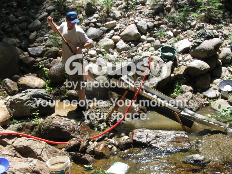

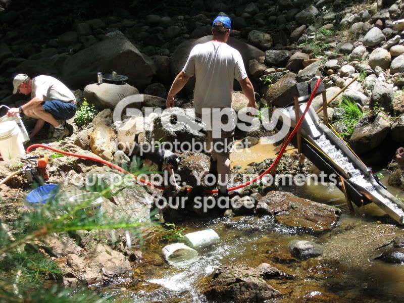

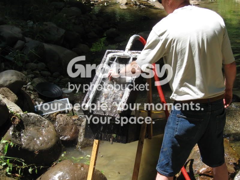

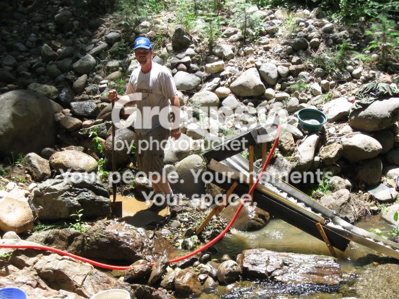

Here it is. My $20 highbanker.
The wood was scrounged up at a Flooring/Siding place. They were giving it away for free. Most of the PVC pipe came from a co-worker. The grizzley screen was from my wife's grandfather. It was all painted with a roll-on bedliner I had from years ago. The pump was my dads.
All I had to buy was a few screws, a few bolts, the hinge and a couple PVC caps and adapters.
The Good, The Bad, The Ugly
The Good: It works. It was about $20.
The Bad: The sluice was to wide for my little Tanaka. We strapped a couple of our sluices to it. It weighs a metric ton. I wish I a BBQ grill for the grizzly.
The Ugly: Well. What do you think?

oh yea looks great... how did the legs hold up?and dont forget im rated to carry 3/4 of a metric ton pre beer consumption. :icon_thumleft: message or call me later.
lol....The legs held up fine. I left the highbanker at the cabin. It was huge! I am already looking to build a smaller, lighter, folding one we can attach our sluices too. I'll let you know about Sunday.

Thanks. I will be using it again this weekend. Unfortunately the sluice I built for it was to wide so a thinner sluice/high banker is in the works to supplement the small pump I have.
