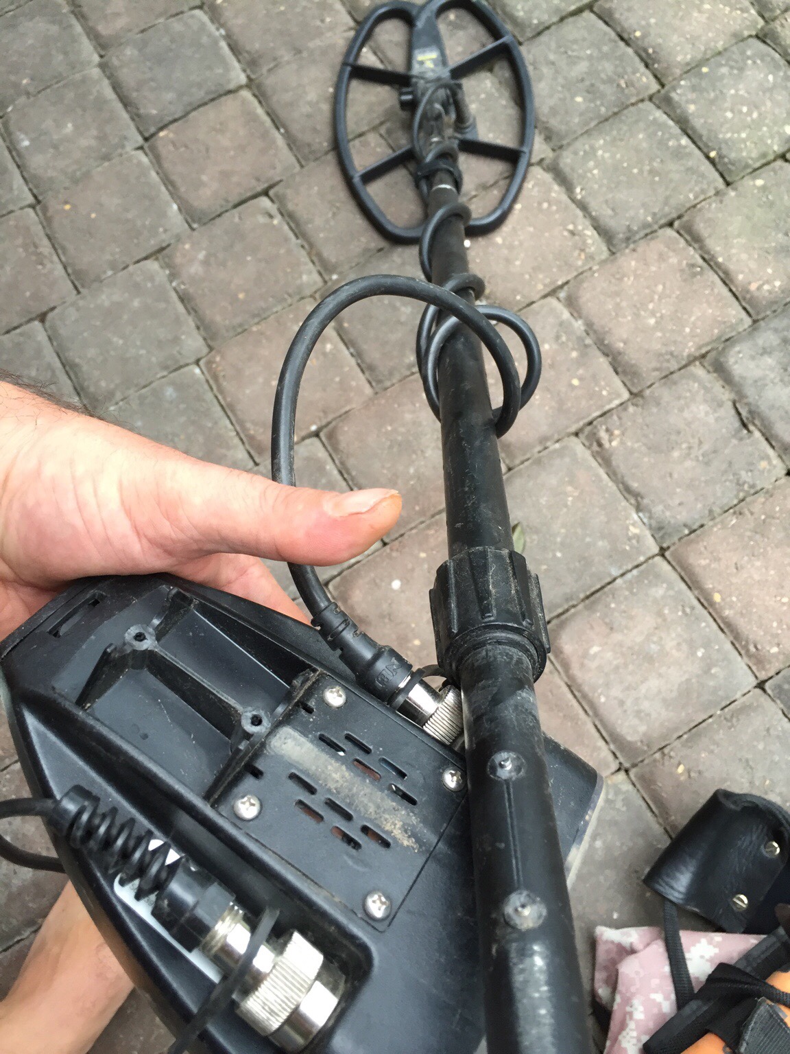

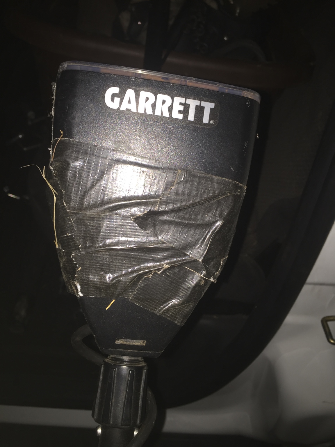

This is the second time that I've done this. I snapped the head off my AT Pro.
I don't want to send it back to Garrett because it took him two weeks to get it back to me. I'm back to using duct tape. Is it just me?

I don't know how to repost the tread but I had one pic

Looks like your pretty rough on it by the pics. Looks like a Nugget Noggin detector after he is done with one. He just piles them all together. Crazy... :)

What is the proper fix?
Had mine 3 years and have managed not to snap the head off.
Looks like you put undue pressure on it [for whatever reason] to cause a fracture like that.
You can drill the holes in the shaft a little larger and get some slightly bigger screws. Easy fix. :icon_thumright:
First thing is to find out what it is he does that keeps breaking the machine. With that knowledge, one can then engineer proper reinforcement that will better last the particular user.
While installing larger bolts will work, I would not consider that in itself a proper fix. Making the bolts larger means weakening another part of the machine - specifically, at the bottom of the head where the bolts go through. Will this make much difference? Maybe, maybe not. Depends on what stresses this detector sees. So it's not just an all-around "you can do it this way" fix, but something tailored specifically for his needs.
I could fix it where it might likely never break again. However, just buried my Mom and have a hell of a lot of family stuff to do right now, as I have already explained to the OP.
In any case, it shouldn't be THAT difficult reinforcing the unit to provide additional strength.
I'm a 6"2, 262lb man and no I don't treat it like my wife's hand. I'm very fortunate that I have the opportunity to MD 4 hours days six days a week, so I definitely get my use out of my AT Pro. I knew I needed a tough detector that's why I got a all terrain AT instead of a delicate Deus. I'm just still very surprised about that one soft underbelly weakness of the AT Pro. Thanks for the help I'll handle it.

You know what ? I wouldnt complain at all, I´d just use some type of chest strap and keep it there and you will TAKE OFF all the weight in the shaft, therefore the shaft will be basically weightless and you will be able to swing 24/7 with no complains!
Try it out before trying to do some fix to get it in the shaft again, it´d be something like the Xcal users do :)
