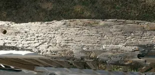

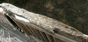

Last weekend I found what seems to be a piece from an old shipwreck The piece is about 4 to 5 feet long noticable wooden dowels, 6 or 7 solid bronze pins, 1 protruding out of the wood about 2 inches, curved piece. Just wanting to know more about it and what i need to do to protect it 20161115_151603.webp20161115_151625.webp20161115_151629.webp20161115_151632.webp20161115_151637.webp20161115_151652.webp

Depending on the location, there are certainly more timbers with bolt holes that come from other sources than shipwrecks. In reality, I am not certain the bronze pins and wooden dowels at intervals equates to a ship timber. Depending on where you found it as well. While the squared end looks to be cut, the rounded end appears natural? that does not point to a ship timber in my observation.
Is there some reason that you want to spent the time and effort to preserve this?
Assuming it was found in salt water, if you want to preserve it, you would need to soak it in fresh water, and keep changing it out, until the salt levels in the water have gone to background.
The pins will be an issue, as they will swell over time if not properly conserved. The wood treatment can vary, depending on what the original wood/use was.

I found it in Kitty Hawk NC, southern shores, NC on the outer banks u know the graveyard!! opposite of the square side is the end that was broken not sure if u can see that well in pics
I guess not really "preserve" but i do wanna make a cool hanging light fixture with nautical rope , and would like for it to last. but just fresh water and keep changin it out to rid of all the salt? Do u think if i do that, that it would last ? I would like to know what type of wood it could be and around what time era it could b from. Im stoked that I came across this. Never before have I seen anything like it.

Yes, this is a very good beginning. In reality, if you just want it to hang, just let it soak off in the freshwater for a few weeks, this will get rid of much of the salt, and the smell. Then let it dry....
The freshwater will take some of the salt out of the metal to keep it from spalling as it oxidizes.
Natural look or typical wood oil will make it look nice, depending on how you want it to look.

got it soaking in bathtub so i an refresh the water everyday

A larger part of the wood found on beaches is not from shipwrecks, but from buildings, docks, etc that have been washed into the sea or down rivers into seas. Sadly it will likely never be known where your piece of wood came from. Also there are many modern wooden boats all around the world so some of the wood we find along the shore comes from those. There is not much wood left on any ancient shipwrecks that can come ashore these days, I wouldn't get fired up about there being a valuable wreck of any kind near where the wood was found.
Remember too that most shipwreck wood is (due to age) very likely to be completely waterlogged, and thus is normally "exposed" (by removal of sand during a large storm for example) as opposed to simply floating up onto shore somewhere.
Certainly waterlogged wood can be pushed around by a big enough storm, but those situations seem rare enough that I'd consider the above first.
