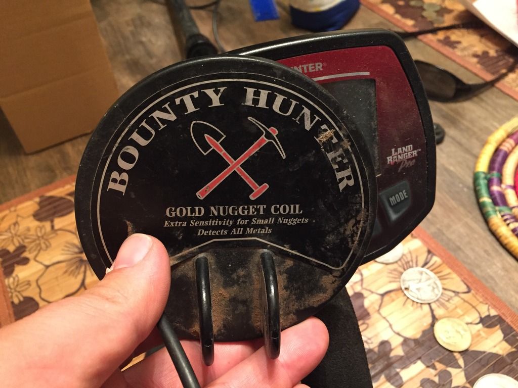

A MDing buddy stopped by and brought a coil for me to try out. He said it was an extra that he bought for his Tracker IV.

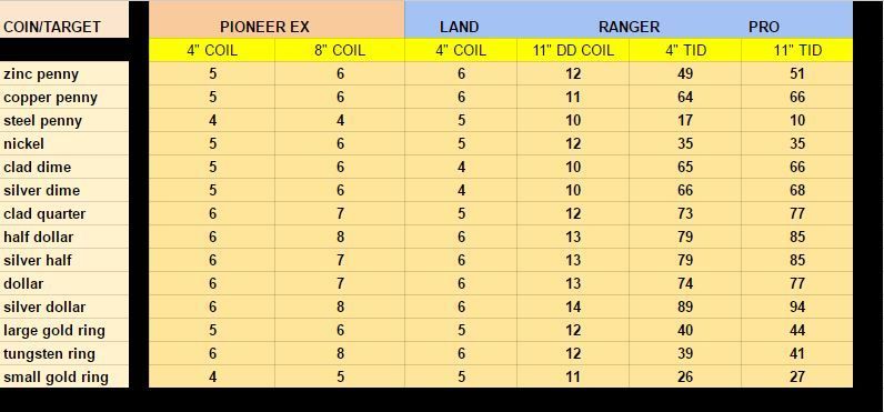

He wasn't sure if it would work with my Land Ranger Pro but he brought it by anyway. I also have a Pioneer EX which should be compatible with this coil, the 6.6 kHz vs. 7.69 kHz issue. I decided to do some air tests with the Pioneer's stock 8" coil and the 4" against the LRP's 11" DD and the 4". I also noted the TID #'s on each coil also with the LRP. Both detectors in all metal modes.

The 4" coil lets me get within 6" of the backstop at the baseball field before it sounds off on it. Depth seems pretty limited to about 3" but all targets were trash with the exception of a copper penny. I will try it out more at a site that might yield better targets. This site was like a hundred beer cans had a medieval reenactment of the Army of Darkness castle seige.
Better results than the newer $30 4 inch coil Bounty Hunter sells for the 6.6khz machines. No sticker on that one...just plain black. It maxed out at 4 inches and the ID readings were spread more than what you show here if my memory serves me right.

The 4" BH coils are concentric and OK for surface hunting trashy areas. Most get 3-4" when used on 7.xx khz machines.
That said, the 5" DD with windings matching the 7.69 khz machines are showing 8-9" depth with faster recovery and pinpoint ID over the 4".

Did some quick air testing...11"dd: cladquarter=74, claddime=65.
Ultra4" : cladquarter= 71/72, claddime = 63.
F5 5" w/ push-on connector : cladquarter=75, claddime= 65

Almost everything ID's about 3 lower on the ID compared to the 11DD. AM air testing seems to be in the 6-7 range on a quarter.
