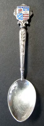

Ran across a few items with mystery marks today. First up is a souvenir demitasse spoon with the coat of arms for Cote d'Azur:
No other markings on it, but it does feel like it's sterling.

On the spoon - likely a French silver hallmark (given that it's a cote d'azur souvenir spoon) - try to compare here French Hallmarks - Online Encyclopedia of Silver Marks, Hallmarks & Makers' Marks for a matching puirity mark.

Didn't see a match on that website. More than anything the mark on the spoon looks like the 82nd Airborne All-American logo. Don't think that's what is actually is though!

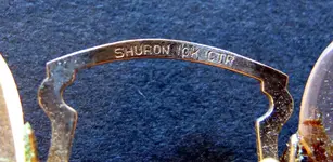

The glasses have the normal GF marks on the arms, but one of them has a different mark on the bridge: "10k CTR". And ideas? I'll put the pics up in a minute.

And the miscellaneous gold filled items, with a close-up of the "10k CTR" mark:
That is really interesting. I did not realize that 10K or 10K G.F. frames came in that style. I've been ignoring anything that wasn't the old wire frames (like Ben Franklin style). Got to keep my out for these types of glasses. The 10K CTR is also really interesting. I wonder is that means 10K Center. It would make sens that the piece that touched your face would be solid gold. Does anyone know what the CTR means?
Yeah, I've been keeping an eye out for any sort of glasses or glasses cases. One pair I found a few weeks back (at the awful estate sale) had aluminum arms and an aluminum trim over the GF rims.
I've found a few references online to "10k CTR" and they're all linked to Shuron frames, but no further information. I really need a test kit...
