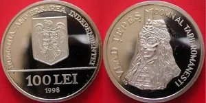

Sidenote, about "regular" or "simple" Tombac:
During World War 2, Canada made its 5-cent coins out of simple Tombac. In photos of uncirculated ones, you can see the "dull golden" color. Check the photos below. One shows the Canadian 5-cent Tombac coin, and the other shows a White Tombac coin from Romania.
