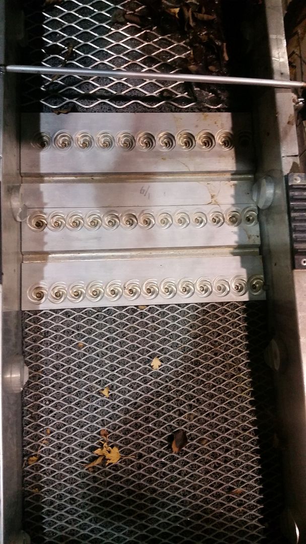

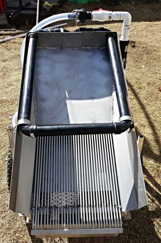

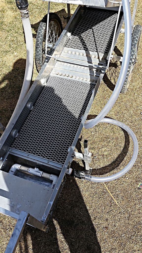

Well I finally had time to finish off my highbanker this weekend. It was mostly just plumbing in the fluid bed but it seems tough to find time to finish off my projects this year. The sluice box is 14" wide and 6' long to the end of the fluid bed. I have 3/4" expanded metal at the top with a section of gold well in the middle followed by 3/8" expanded on the bottom. Then the whole sluice dumps into the fluid bed and exits out the end. The hopper is 34" long and has a 3/16" gap between the grizzly bars. Now if the rivers would thaw out enough up here I could go and test her out. I also want to say thanks to Goodyguy, his threads on fluid beds really helped me out.

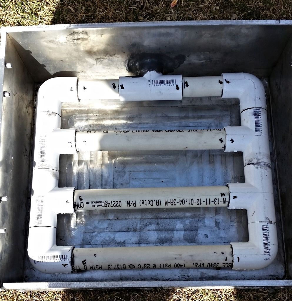

what are the specs on your fluid bed section?

It won't be long for us now. The weather has been real nice and the rivers are starting to melt. The fluid bed is 14" wide x 12" long x 3" high. I'm running 3/4" PVC with 3/32 holes drilled in the bottom.
