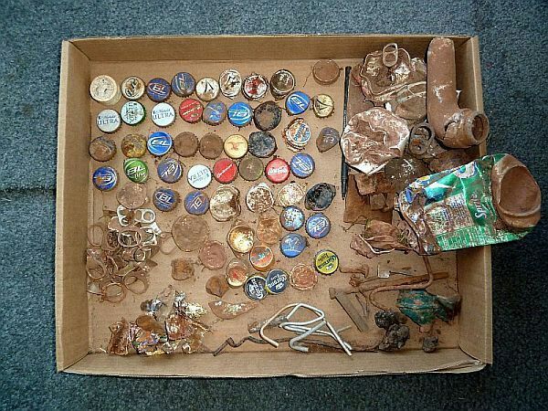

Here is the junk from just one hunt in a real trashy park on my very first hunt with a large DD coil I just purchased for my Vaq to use in my mineralized soil.
Notice the amount of pop tops, that is why using concentric coils in sites like this makes sense to me, these are usually a non issue using that type of coil.
