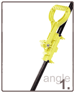

Get the Pro Handle. it really makes it easier to lift full buckets of sand while in the water. Will not break or rust, all SS hardware, multiple positions.
Kellyco has them, as well as Home Depot . http://www.kellycodetectors.com/accessories/pro_handle.htm
