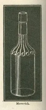

The illustration below is from the 1906 Owens bottle catalog. It is listed in the book as a new design in 1906 and referred to as a "Maverick." Notice the design with the so called tear drops with the circles in them, which is very similar to skite's bottle. Here's a little more info about the style ...
These bottles have fluted or swirled features molded into the shoulder and/or lower neck. Glassmaker names for the many variations of this style were "Fluted Neck Whiskey", "Minnesota Brandy", "Maverick Brandy", "Starlight Brandy", "Chicago Fancy", and most likely others.
Note: Bottle designs were registered just like patents. Also note above where it states "many variations."
The "Maverick" style is not listed in the 1920 Owens catalog.

1906 Owens "Maverick" Bottle
Skite's Bottle

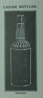

The Maverick is also in my 1904-05 book. Its labeled trade name "Maverick Brandy" But I thought the "Delaware Brandy" was a better match. Ill take a pic.

The Minnesota Brandy, Chicago Brandy, Chicago Fancy, Starlight Brandy, and the Fluted Whiskey among many other registered Brandies are all in my Illinois Glass book. It has all the shapes available for purchase in 1904-1905.
It also covers everything from preserve ware, medicines, syringes, fish globes, druggist sundries and perfumers ware and as well as shop ware and glass labels. Its a great book for early 1900 glass.
Illinois Glass and Owens Glass merged around 1929-1930 to become Owens-Illinois Glass Company. Here's both bottles together. Your "Delaware" may be a perfect match.
Illinois Glass

There are slight variations but I took the time to search through the entire liquor bottle section. I wasnt just taking a wild guess.
I even have a soda section. I dont think any more proof is necessary but is the Delaware Brandy in the 1920 Owens catalog?'
Thats close enough for arguments sake without further pictures. Of note here is that it appears that at some period this registered Brandy was used for Whiskey. I dont know if thats important but I have no problem with it. We may find it was used for something else.
