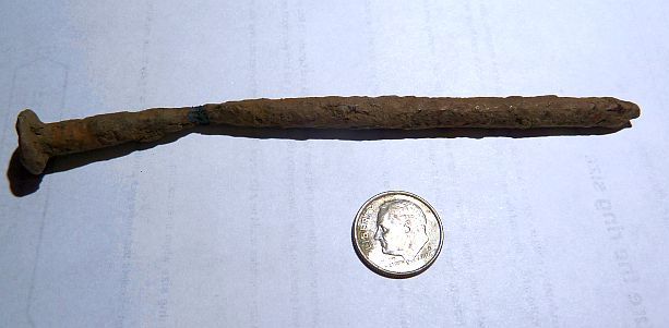

This detector is around 25 years old ( Wilson ) and my cz6a fails this test along with my other Fishers. Anyone with a F series care to try this test.

I am asking for someone with a F series to perform this test, that is all. I tried this test outside and still my Fishers failed.

I tried this test using my F70 using a small phonebook and another book that added up to about 2-3" thick plus a rusty nail approximately the same size as yours...and failed.
Totally silent when the nail was placed directly over the coin.

One hole I opened up had this big ol' nail in it right in the center.
I got that out and kept digging down about 2 more inches going after a good high tone I heard when I first swung over this spot and in the center of that hole laying directly under that nail was a dime.

I dug down and found this square nail at 5".
Once again I continued to dig and found this coin that was again laying about 2" deeper directly under that nail.
I mean dead center under it.
Air tests are one thing, real world results can be totally different.
