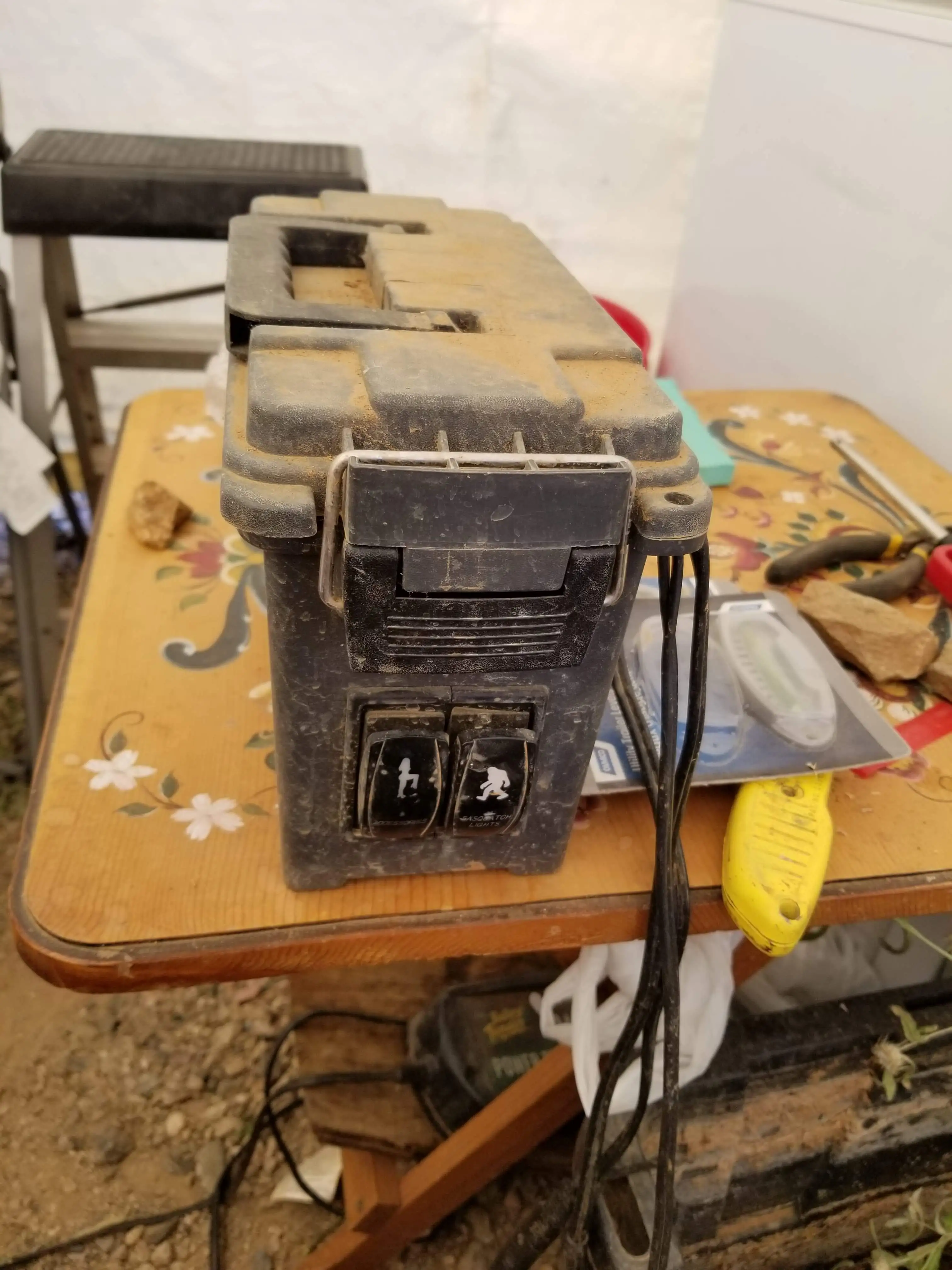

I mounted it in this ammo box and put in the switches. The bigger one will fit in the larger ammo box. I bought this one as a test 3 years ago and it works fine with the charger or solar, but it just runs a few hours alone... but it was $200 when I bought it. More then the biggest one now... but I run it and it runs well.
