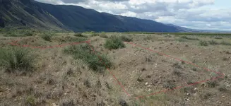

First thing I thought when I saw this on the Columbia River was dredge tailing, but it's actually more of a snaking pattern than the stacked arcs a dredge would make. This area on the river did produce gold. Untitled.webp

Well thanks to both of you for doing all this free research for me :laughing7:. I thank you chlsbrns for the input especially the history links, but I'm going to have to go with Goldwasher on this one. Like I said before I don't have much faith in the accuracy of the location descriptions, not that it even changes the fact that there's gold where I found it. Just looking at this logically, where there's gold in the dirt and it seems like there's been mining activity, I'm saying this was a mine. One thing I thought about today was I don't believe this was probably a floating operation as the piles are at least 10' maybe closer to 20' above the present water line which should be about the same as it was back in the day. So here's some pictures I took. DSC02285.webpDSC02283.webp

You're right, everything down there is river gravels, but really the entire Columbia Basin is river gravels, either from the Columbia proper or from one of the Missoula Floods. I think a lot Grant Co has been underwater at some point or another. We dry classified a bucket of dirt and panned it at the river. One real flake and a few colors in one pan. At least 10 specs per pan and maybe close to 30 in one. Drywashing could be a possibility but I would have to go back and get some better tests, I didn't really find enough while we were there to get real excited.
