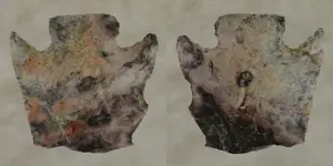

Artifacts heated after knapping have at least four characteristics.
1.Color change , most materials turn pink or red depending on the amount of heat.
2. Surface Gloss , most materials become more glossy after heating.
3. Potlid/Popout Scars, rough irregular depressions where flakes have fallen off from excessive heat.
4.internal Fractures , in translucent material these occur before popouts.
Dove of white Vanport with popout scars on shoulder and tip.
Prehistoric doves were not heat treated before knapping in Ohio.
2021-01-312.webpVanport flint that has turned black. This was a much greater temperature than the 600 to 750 degrees used to heat treat Vanport before knapping.2021-01-31.webpThis Upper Mercer black has popout scars and is more glossy than if it were unheated.DSC_6893.webp Vanport showing internal fractures.DSC_6897.webpDSC_6901.webpThese are examples of grey Nellie Chert heated after knappingDSC_6924.webp Here is a gunflint that turned white.
If you have examples and ideas please post them.

Good tutorial but there is one important point you missed. When you pull a preform out of the kiln (or fire pit) it is not glossy. You only see the gloss after you remove the first flake. Plus, it has to be heated hot enough to form the gloss. It's the same with accidently heated artifacts. They will not show gloss until chipped. Gary
Right these were heated after they were knapped not to improve workability.
