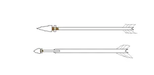

The first type would have been one long shaft... all one piece with the spear attached right to it. The second type would have a fairly long shaft but at the end it would be socketed so that tips could be put into it. The advantage being if you hit say a deer but didn't kill it with a type one it could very well run away with not only the spear head itself but the whole spear- which was a lot of work gone bye bye. With the socketed end the main part of the shaft would simply fall out and leave the forshaft with the spear head imbeded in the prey. Here's a terrible illustration for you:
Thanks Cannon- I appreciate that- all. So the contracting base style points of the larger variety were meant to fit and be used in the later, type 'B' atl atls? Meant to disconnect from the shaft-extender and stay in the pray, yes? That would explain a lot. Your illustrations help a lot. I always imagined an atl atl to be more like a jia-ali (sp) (Sounds like hi-ly) scoop-tosser. Or a lacrosse stick- something that would be used with an over the head throwing motion- like a baseball, rather than a spear-throwing motion. Hmm.
My little drawing there isn't of the entire atl atl... just the shaft, not the lever. I believe the contracting stems were used in what really amounted to a modified version of the first type. See how in the first type there isn't any socket and the point is tied right to it? Well they found that by creating the socket they could save most of the spear shaft and many hours of work and switched to type two... and this is the point in history when points get smaller again in spite of the fact that the bow and arrow hasn't been invented yet and this is also why some have argued for many years that the bow and arrow was invented before what most think it was... anyways.. the third evolution was with the contracting stem which would fall out or stay in upon impact.. it was used I believe on a type one, put right into the main shaft, and when used only the point would stay in- this of course again saved many hours of work by allowing the hunter to more often than not retrieve his spear shaft if not the game itself.. and this third evolution also saved the time required to create the smaller 6-10 inch piece that fit into the socket.. now some simple pine pitch or similar natural glue would be all that would be needed... you could carry a few of these in a pouch and simply replace the point itself. This also explains the contracting stem because it, by design, is not very well made for tying it onto something tightly... all different kinds of bases are MUCH better suited at being tied on tight and not meant to come off. This also explains why many contracting stems appear to have been made by simple percussion flaking with not a lot of pressure flaking... they were expendable points, at least more so that the spears they rode on. It also explains why very few contracting stem knives are found... they don't haft very well to handles although IT CAN and WAS done.. just not real often.
