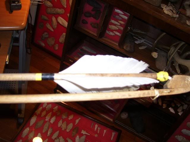

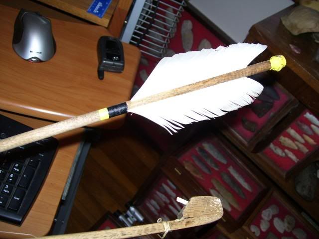

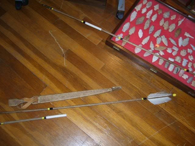

I throw the atal atlal, quite often. It have been able to get quite accurate with it.  I can see the ancients standing back and throwing these from a distance.  When I try to throw mine for say 50 yards it never hits the mark. If I stand back and lob it at the target long range I can hit a target.  If a few of them stood back and lobed these then It would look like it does in the movies when you see the archers shoot in the air and the arrows come dropping in on the targets. I can also throw a line drive with the atal atal,  I'm only accurate up to about 50 feet or so. No doubt in my mind you could drop small prey like that.( deer size) The points that I find in Mo. all seem to big to be shot by a bow or an atalatal.(most of the points I find are at least 2 inches long) Is that why the arrows are so long? does that help counter balance the point? If the point is heavier in the front end, it will never do a line drive straight ,and will nose dive. which makes me think that these points were lobed at the target.  My atal has the slip in shaft, like the shafts Matt showed. When I pull my arrow out of a target, dirt etc. the point always stays in the target, and I have to remove it and plug it back in, or put a new arrow shaft into it. It just seems to make sense that if I were to shoot a mammoth, or something big and pissed off, that I wouldn't run up to it to pull my main shaft out to reload it. What I am trying to say is I don't know if I buy that or not, because they were firing the whole arrow. Now after the kill it made it probably easier to just go up and pull, and if the arrowhead had damage etc. they didn't have to start over just plug a new tip in and they are ready to go again. JMO John P.s if you do'nt own an atal, get you one, me and my boys love to throw them they are a blast.
Heres a pic of a cheap one, that you could probably make yourself. This is a practice atal, they are 5 foot arrows. Looks like the pup got a hold of it. >:( John
