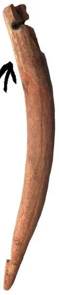

Many years ago, I recovered this piece of worked bone in an area where many Paleo to Early Archaic artifacts have been found. My best guess is that it is an atlatl hook, though I am uncertain how it was hafted, even with the obvious grooves.
toolboneunid.webp​
This bone is well-mineralized, but not much degraded by stream polishing (you can still see evidence of cuts in the end-notch.) There are no apparent broken edges.
The bone is solid cortex with no evidence of the marrow cavity. Cortex that thick implies that this piece was removed from a substantial bone (including antler).

My questions, then, are:
1. Is my find an atlatl hook, or is it some other sort of tool?
2. How was this bone piece hafted to an atlatl or to some other tool?
Speculation welcome! :icon_salut:
Harry, you aren't supposed to ask questions!! Just kidding you. You are so knowledgable, and I'm sincere in saying that, that for you to need advice kinda blows my mind. I'm glad to see you asking and wish that I could be of some help. If you would like my vision, I'll tell you what I see. Actually, what I do not see. I do not see a hook that could hold a shaft. If an atlatl could be made to stay on this piece, I still couldn't imagine any accuracy on a target. You mentioned water polish. At certain angles the piece looks like it has a socket on the end. Could water have just worn this bone down creating the appearance of an artifact? Could the grooves have been cut into the bone during butchering with time and water altering the appearance of the cut? Not sure Harry! You have helped me on several occasions. I know I was no help. I still wanted to let you know I like this bone and it's mysterious alteration.
I've come back to look at this several times. I don't know if its the odd computerized image but something looks very "off" about it to me.
It looks almost exactly the same material as the resin cast in the other photo.
I know you have a pretty good eye most of the time so I'll have to take your word for it but by the photos alone I wouldn't even think it was an artifact.
One place where it seems to be "cut" in a rectangular shape is the only thing that looks like it "may" not be natural to me... even then I've seen nature do some strange things.
I've found alot of bone artifacts none of the material ever looked like that.
I love polls ! Looks like one. Not everyone made the same item identical. That is my theory and am sticking to it.

I still cannot imagine a reasonable way this piece of bone could be tethered to a throwing stick. But, something was tethered to the piece . . . the grooves are too obvious. Maybe that's all there was . . . some cordage. Maybe the smooth curve on the inside of the grooved end is simply to protect a knot. Maybe this was the lead end of a fish stringer that could be staked into the riverbank.
I considered a fish gorge, but it seems a bit large for river fish and not big enough for a gator. Someone spent a good bit of time carving this tool, and I suspect that it was not meant to be a throwaway.

Harry, do you know if early archaic natives trapped food? I'm not talking a steel trap. Rather, a box with a trip line that would catch the animal and keep the animal alive. I see this piece being used with a line/rope of some sort. Bone is light enough for a ribbit or animal of that size to trip. Bone is nothing that would spook an animal. I know some animals are not good to eat without cleaning their diet a little. Would this bone have been fossilized during its time of use? The thick groove may have held a drop door. After the line was tripped, the flat would lay on the ground leaving no way out. I can't explain what I see in a manner that makes any sense. It's a cool piece. I better stop typing. If I look at it much longer, it's liable to be the first computer. Lol! Nice threat Harry!
Harry, I can't tell if it's been worked or tumbled. It looks like a fish bone, either a tilly bone/hyperostosis or another bone of fish. We call them fish bladders but that is not what they are. I have found many of these, the groove is natural (originally if modified later...) and it's broken along the midline. I've seen these in fresh large fish on the spine and again, many in Miocene/Pleistocene deposits in FL. What do you think?

That's all reasonable speculation, guys. However, this is textured mammal bone (including possibly antler), not a Tilly bone. This would have to be from an enormous Tilly bone, Tom, either recovered and worked while green OR mineralized then fractured into an astonishing shape. I've seen a lot of Tilly bones, but never one that looked like anything but a Tilly bone.

Trap doors and box traps don't sound feasible, NCfh. Dead-fall traps with this piece of bone as the trigger is more feasible. Keep in mind though that this object was found in a river bottomland in which there are no large flagstones exposed for use as a dead-fall. The limestone would have to be retrieved from the river, and what right-thinking NA is going to do that when a snare (multiple snares) would require less work?
