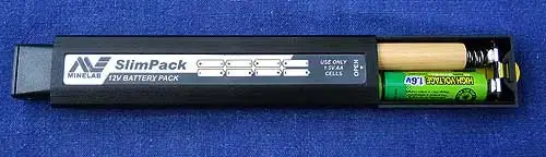

The digital cameras & GPS receivers love them, but I decided to check with Minelab before I tried them. Minelab would not recomend using them. Fully charged, my battery pack read 18.6v!
So, I made two "dummy" cells. I used large nails, cut them to size on the lathe, then turned wooden sleeves on the lathe to just a tad shorter than a AA cell, and glued in the nails.
NiZn2.webp NiZn3.webp​
Now, with freshly charged batteries, I only put SIX cells in the AA battery pack, and use the two dummy cells. That gives me 10.8v (at 1.6v per cell, or 11.8v at 1.9v per cell), which is higher than the 9.6v Minelab rechargable battery pack, and still within the 12v max recommended by Minelab. I can use the E-Trac for several hours before the battery even begins to show any signs of weakening. When it does, I just pop out one of the dummies, and put in one of the two NiZn cells that are still fully charged. I'm back to full charge again, and I still have another fully charged cell to go. It works great, and I never come close to getting near the danger point of over voltage.

Hello everyone,
I know this thread is a little old, but I bought these batteries a little over a year ago, and mine read 1.8v and sometimes as high as 2.3v after recharging too. They do settle down after taking them out of the charger, but that initial voltage is quite high.

That's just brilliant! I love when people put that much thought into subjects like this! Now I'm looking into doing something like you did with my MXT battery pack! Thanks for the info!

Atrus, Good show! Where did you get the NiZn batteries? Good idea, but I would have used copper rod instead of steel nails. The steel nails are presenting some resistance in the circuit and using some of your power. Frank
