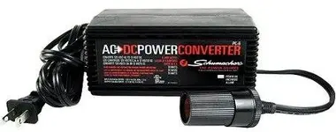

However if you run the pump at home then you do not need a battery at all! Just use a 110v to 12v 6amp converter.
Cut the cigarette plug receptacle off and bare the two wires to hook up to the pump.
This way you can run as long as you want.
Under $20 at Walmart.
GG~
Ugh... that would have been perfect and cheaper... but obviously I need to learn.. sometimes.. that hard way teaches best!. All in all I only spent 50 bucks for the battery and charger with shipping so it's no big deal
