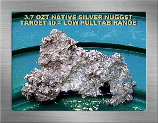

3.7 OZT SILVER NUGGET SFPANYG17.webp​

Jim, as always, it's good to hear from you, and that's a fantastic picture of a very sassy silver nugget!
I hope your summer is a productive one with lots of silver linings.
