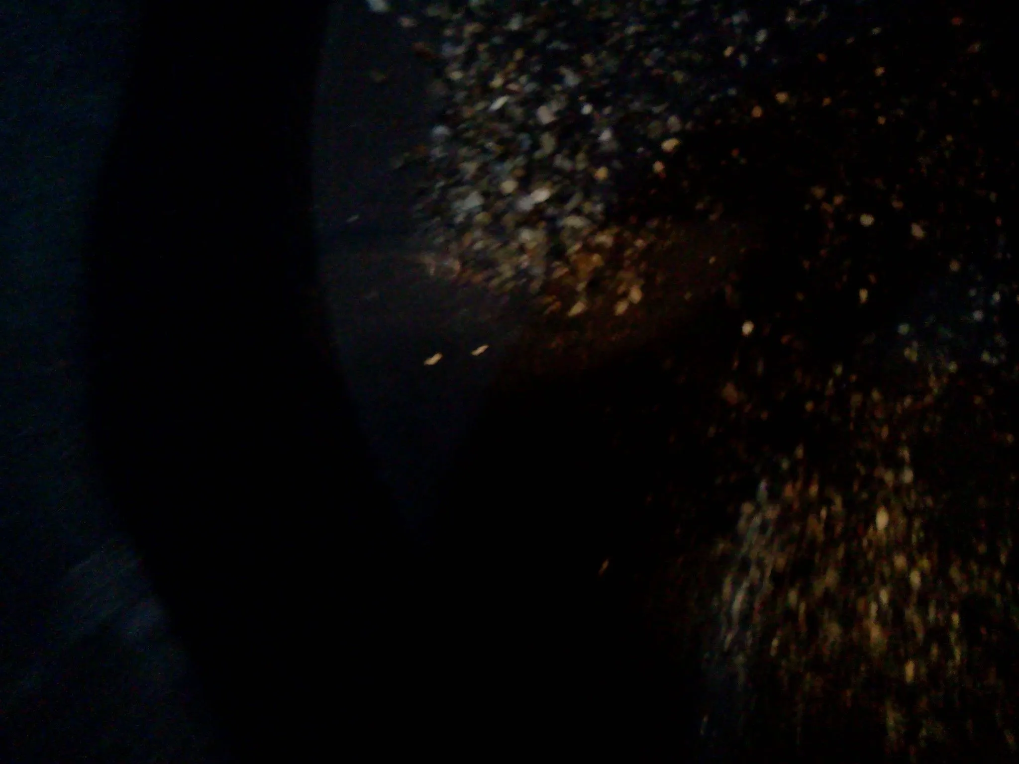

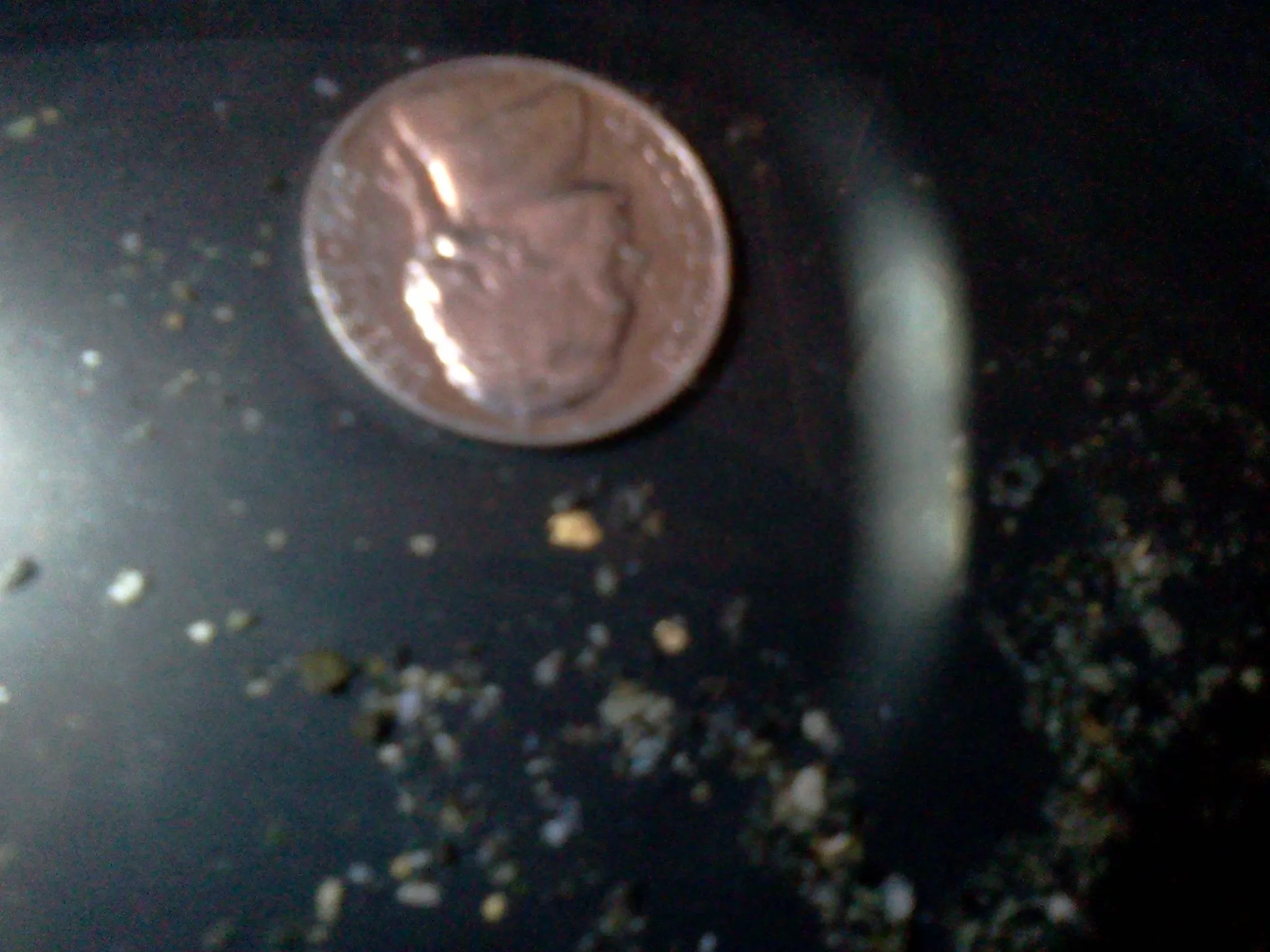

Small but still proof. These refused to go thru a 20 mesh during processing the 5 gls today. Cell pics so sorry for quality but yes, that's the biggest flake I have ever recovered right next to the nickel. I can barely get it to move in the pan :icon_thumright:
